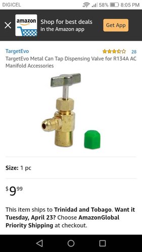

Fellas where can i get this locally? Tried maraj air-conditioning and a couple other similar places in the north with no luck...
Postby Ted_v2 » April 12th, 2019, 10:59 pm
got that by general appliance in san fernando by RIG

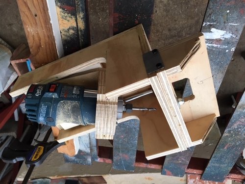

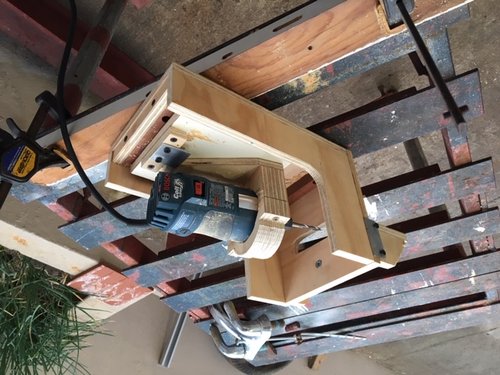

almost finished the slot mortising machine.
These designs are good.
However I found the drawer slides on the heavy side, prob 2+lbs.
Some guys use shower curtain rods as rails with blocks sliding on them.
I am going to build over and use that way.
Also dimensions can be adjusted to make more compact.

Pask on YouTube made a nice simple one. When I get some time I’ll try it.

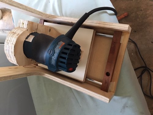

Did some work on the design using rods instead of drawer slides.
Will finish next time I work on it.
Better design than the drawer slides, slides easier and no play at extension of the slides.
Got the chromoly rods from old shocks, made a mess dismantling the first shock and got sprayed with foul spoilt hydraulic oil.
Need to work up connection to vacuum hose for dust collection next.

Looking good. Your work bench looking like an ironing board.
After you finish with that you have to upgrade to a pantorouter.

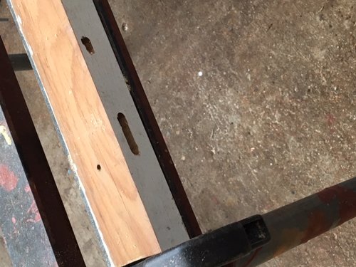

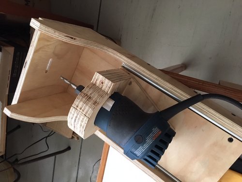

Pretty much finished the domino clone, only thing to do is a top handle, the width stops/calibration, forward stops with spring load and possible vacuum attachment.
It works great however there is some flex on the router mount plate as the locally available plywood is rather soft.
Anybody know of any better quality options for plywood ?
Worst case will use a metal plate.

Try some StarBoard from MarcOne.
