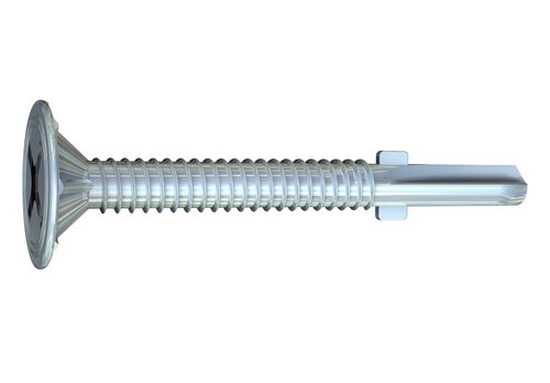

What kind of screws can be used to attach concrete board to an existing frame made from rhs and flat steel??

Purlin screws

My issue with the perlin screws is the head of rhe screw that will be sticking out a bit.
Any other options?

Jerry84 wrote:
NR8 wrote:Purlin screws
Any other options?
Sent from my SM-A705MN using TriniTuner mobile app
These are the screws used for concrete board. You’ll have to counter sink the board a bit.

matix wrote:
Any other options?
And these screws would be able to go into flat steel or rhs comfortably?

Jerry84 wrote:
matix wrote:
Any other options?
Depends on the thickness of the RHS and flats, yes. You may need to use cutting countersunk screws for your application or pre-drill the materials. What’s the thickness of the concrete board?

1/2" thick concrete board. Flat is 1" wide, 1/8 thick. Rhs is 1x1 rhs

Try to get these,
If you want good quality fasteners, you’ll get them at Agostini / Hilti store. Any hardware you’ll get the cheaper ones.

aka tek point countersunk screws
seen many electrical work where fellas run them into ibeams, however when i tried i fail

pugboy wrote:aka tek point countersunk screws
if they running them into i beams is either they pre drilling the hole or using torpedo screws
The quality of screws vary a lot.
