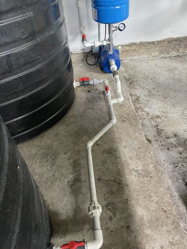

Looking for a suggestion
My father has an apartment building with 4 units which he started to build about 30 years ago. He completed one unit at a time so that the income could go towards building the other unit. In this regard, each unit was facilitated with its own pump and tank.
Due to the water shortages we experienced in recent years, he was in a situation where he had to change water pumps occasionally. He opted to have an extra pump on hand but the situation is the pumps are different brands. Therefore everytime one is changed, plumbing is reconfigured (inflow and outflow location).
I was wondering if there is some kind of flex line (similar to those used for supplying toilets and vanities) that can be used in this application.
I'm also open to suggestions. Size of pvc at pump locations for all units is 3/4".
Re: Building a house in Trinidad
Postby adnj » June 12th, 2024, 7:02 am
Jerry84 wrote:Looking for a suggestion
There is flexible copper and flexible stainless steel that are made specifically for water heater connections. There is also PEX tubing that is used for general water supply plumbing.
You'll probably be happier with PEX.
Posts: 18414
Postby Dave » June 12th, 2024, 7:03 am
I know in the States when they are plumbing water heaters and with the varying codes they are obligated to use flexible lines. They are available..not sure about the availability locally.
Jerry84
Posts: 520
Postby Jerry84 » June 12th, 2024, 7:10 am
PEX and it's fittings available locally ?
The stainless steel flexible tubing, can it take the pressure of the pump?
Posts: 29380
Postby pugboy » June 12th, 2024, 7:44 am
pex is used by some of the higher end plumbers locally so i presume it’s available
you could use a union fitting up to a certain point so after that the piping doesn’t change
you only do over the piping before the union
just buy a bunch of the same brand unions to have on hand, or use threaded fittings instead of unions
why did pumps fail?

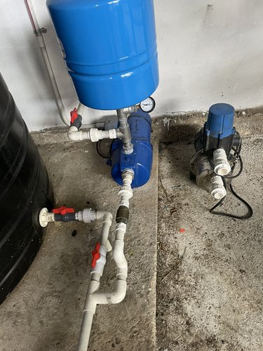

matix
Posts: 2367
Postby matix » June 12th, 2024, 9:09 am
Similar situation with a fix that worked for me. If you have the extra pumps in hand. Do the plumbing on the spare pumps to facilitate an easy swap using unions. Get the damaged pumps repaired and keep them as spares. Cost wise I’ll suggest sticking to PVC. Picture shows the ease of unions, so if pump needs to be replaced, really easy swap.
Jerry84
Posts: 520
Postby Jerry84 » June 12th, 2024, 11:47 am
pugboy wrote:pex is used by some of the higher end plumbers locally so i presume it’s available
why did pumps fail?
do you have dry tank protection float switches?
Initially my dad didn't have the float switch or whatever it's called. Had 2 pumps being damaged because of no water, one actually damaged because of a surge (at least that's what was told to us) and another conveniently disappeared when a tenant was given eviction notice (made arrangements to collect keys on a particular day as per agreement but they left before without out knowledge)
Back then Goulds pumps were 2500 -3000
Now it much more so we're going for the cheaper options now.
Posts: 3615
Postby alfa » June 12th, 2024, 11:51 am
Pentax is cheaper and performs well. The pump that was supposedly damaged by a surge you should get that properly checked. A surge can damage the electronics in the smart head but cannot burn the actual coils in the motor
Jerry84
Posts: 520
Postby Jerry84 » June 12th, 2024, 12:11 pm
I understand this. Thanks man
In my situation the pumps are different brands and all already have the pressure tanks and switches installed. My issue is with the different brands of pumps, the lineup is somewhat different for the inflow and outflow on the pump.
Jerry84
Posts: 520
Postby Jerry84 » June 12th, 2024, 12:12 pm
alfa wrote:Pentax is cheaper and performs well. The pump that was supposedly damaged by a surge you should get that properly checked. A surge can damage the electronics in the smart head but cannot burn the actual coils in the motor
If memory serves me correctly I believe it was the electronic components that were damaged. Vaguely remember something about a capacitor.
None of the pumps have smarthead though...all use pressure switches and pressure tanks.
The attachment IMG_9825.JPG is no longer available
Understood, what I’m getting at, the lineup doesn’t matter. You can do the plumbing with PVC fittings to line up any way it’s needed. And keep the additional pumps for emergencies. Make sure it’s the same type of unions so when you need to switch, it’s works perfectly.
Understood. Thanks for your advice.
