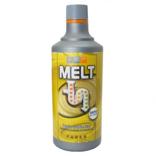

I have a bathroom drain that's semi clogged. There are no available clean outs as they have been covered with concrete. Is there any liquid I can pour into the drain to assist with uncloging?? Or any solutions

Jerry84 wrote:I have a bathroom drain that's semi clogged. There are no available clean outs as they have been covered with concrete. Is there any liquid I can pour into the drain to assist with uncloging?? Or any solutions
Use a plunger
Re: Building a house in Trinidad

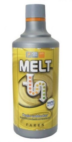

Postby eliteauto » September 30th, 2022, 11:07 am
Check your plumbing store for a liquid called "Melt" you'll need nothing else
PariaMan
Posts: 3745
Postby PariaMan » September 30th, 2022, 11:11 am
Used it worked like a charm but make sure you get rid of excess water before applying so it hits the blockage concentrated
Posts: 9322
Postby *KRONIK* » September 30th, 2022, 12:13 pm
Go to the hardware and ask for MELT
Bear in mind its concentrated sulphuric acid
But it does work.
Run some hot water after and yuh good to go

Posts: 29380
Postby pugboy » September 30th, 2022, 1:21 pm
that melt is serious stuff, very violent when it starts to mix
i used it the other day, just like a 1/2 cup and when it reach outside in a box drain it still fizzing up with the big water in the box drain
it doesnt give off fumes like muriatic acid, it gets very hot
Posts: 9322
Postby *KRONIK* » September 30th, 2022, 2:41 pm
Yea
It reacts with water exothermically
1 drop of that spray out the drain hole and land on my arm, thing burn off my skin with no mercy
