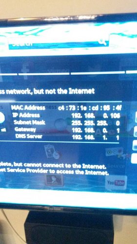

not too sure whats going on with my TV ( samsung smart)
never had an issue before and it worked fine streaming netflix
Now its showing connected to wifi but cannot access the internet
mind you the fifi works fine on the laptop and fone

X_Factor wrote:not too sure whats going on with my TV ( samsung smart)
Your TV DNS working properly?
Re: *** THE OFFICIAL HOME THEATER & AUDIO THREAD**
Postby X_Factor » February 25th, 2015, 4:22 pm
thats wat i get
Postby Redman » February 25th, 2015, 8:06 pm
Is it doing that when it automatically selects ip and DNS?

anybody have issues with internet and their samsung smart TV
alot of my customers all over the country who purchased samsung smart tvs are having no internet issues on the tvs
one particular customer we had set up with google DNS is working fine, so i suspect its a DNS issue, anyone else?
Postby Redman » February 27th, 2015, 9:59 am
X
you tried the cycling between the auto and manual dns?
I am using the smartdns server but it didnt work the first time - I cycled the tv through the auto(local dns) and the smart dns and it worked the second or third time.'
Postby X_Factor » February 27th, 2015, 10:10 am
not sure of the manual dns to use
thatlife
Posts: 276
Joined: February 7th, 2013, 1:27 pm
Postby thatlife » February 27th, 2015, 10:37 am
i set up a samsung TV a month ago and noticed the issue. Netflix did not work, tried updating etc.
only when i use the Google DNS it worked 8.8.8.8 and 8.8.4.4
all other customer TVs are down except for that TV with the google DNS
Postby Redman » February 27th, 2015, 10:38 am
oh
well sign up with smartdns Duane added a link in this thread..they give you a 2 week free period
try it with their DNS
Im using that DNS on the router and the TV for the 10 days and its been stable. no issues
Its working with Netflix and all the other apps on the Samsung.

thatlife wrote:i set up a samsung TV a month ago and noticed the issue. Netflix did not work, tried updating etc.
google DNS doesn't mask your IP to make you appear as if you are in the USA. Smartdnsproxy and unblockus are needed for that.

^ not thats not what i mean't
i'm just highlighting that alot of samsung TVs as of recently the internet apps stopped working, like NETFLIX etc. (I suspect an update)
they only way it worked on one is when I manually entered the google DNS
I was wondering if anybody here with the samsung TVs in Trinidad have had the issue, I sold a few of these TVs and customers called to let me know the internet is not working and yesterday I got a call from a customer who did not buy one from me but is a Samsung brand had the same issue

ok, i found something
posted 3 days ago
http://www.myce.com/news/samsung-smart- ... age-75099/
" Update 2: User Flavio Torres has posted a dump indicating there is a DNS issue indeed. "
