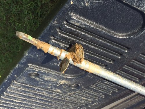

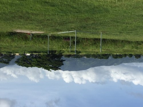

end up making a 3" hand auger with some pipe
worked very good, dug 2ft holes.
trick is to put water to keep soil damp or the blade does not bite the soil well and move the soil
Postby rspann » September 17th, 2017, 12:49 pm
You dig it upside down, it must be easy. All the dirt fall out while you digging.
