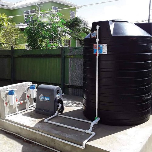

Are there any local solutions for water pump housing but the ones with tank and not the smarthead type? (They will need to be bigger). Or better to go custom?
The pic is from Water Source.

zorced wrote:Are there any local solutions for water pump housing but the ones with tank and not the smarthead type? (They will need to be bigger). Or better to go custom?
Feel you might need to customize . What is the benefit of the smart head over the tank though ?
The smarthead electronically engages the pump. Sales person did not do the best of jobs in convincing me, so my plumber made it easy to go with the pressure tank instead.
Just saw this write up today, check it out for more info.
The point about it being very sensitive to leaks could cause higher electricity consumption till repaired.
wheelbarrow wrote:
Dave wrote:Definitive guide now.... smart head vs pressure tank?
Smarthead
Pros:
Protects pump from running if there is no water being pumped.
No maintenance until something is damaged.
Ease of installation. Jus connect pipes and plug in.
Simple repairs as it's either the circuit board, diaphragm or base will be the issue with a smarthead. If cost of repair parts crosses 1/2 the price of a whole smarthead, jus buy a whole new smarthead.
Passive protection of motor winding as circuit board will most times burn out in electrical issues before pump motor.
Cons:
Too many cheap poorly made models on the market make sure to buy one originating from Europe.
Circuit Board damaged my voltage issues.
If SmartHead is damaged most times pump will not run at all, this means no pressurised water until repaired.
Very sensitive to leaks on system.
Some models cannot regulate cut in and cut off pressures.
Pressure Tank
Pros:
Can set cut in and cut out pressures on pressure switch.
Once properly sized, it will ensure that pump motor runs for at least 1 min when the motor comes on, this will allow for proper cooling of the motor.
Very simple to repair and conduct maintenance, and if the pressure tank or pressure switch is damaged pump can still temporarily run until damaged part can be replaced.
Cons:
Cannot tell if no water is being pumped (unless a float switch or low level pressure switch is used)
If a valve supplying water is locked off in error to the pump, a normal pressure switch will not know and the pump will run without water and eventually lock up and burn out the motor.
Possibility of voltage drop issues with the use of float switches that are installed without the proper size of wiring
Hassle of having to run a float switch out to water tanks which are sometimes located far from pump
Also, if you don't have a float switch or low level protection installed on a pressure tank/pressure switch system your warranty will be voided.
Needs Maintainance. Pressure tank air pressure should be checked every 6 months.
Pressure Switch and pump motor can be damaged if pressure tank air goes too low and pump begins to short cycle.
Most local distributors/hardwares have options with pressure tanks that are too small for the pump, improperly setting the cut in and cut out pressures with these small tanks will lead to premature failure of the pump.
Alot of cheap, poorly made, disposable pressure tanks on the market which do not have the option to replace the diaphragm.
Larger higher quality pressure tanks that can be repaired are very expensive.
Please make sure you install an outlet check valve to protect both the SmartHead and Pressure Tank from mains pressure.
I will add if I think of anything else.
You can use the same housing just place the pressure tank on the outside, not on top the pump.
Posts: 29374
Re: Building a house in Trinidad
Postby pugboy » November 8th, 2021, 9:43 pm
If your pressure tank is a large one with built in stand,
You can place it anywhere, doesn’t technically need to be connected right at pump.

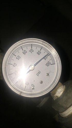

Should i be concerned if my water mains pressure hits 90psi once in awhile. Haven’t got any leaks but is it possible for wasa to send too much and cause damage?

90PSI? that's real high from WASA. you sure that measurement correct?
eitech
Posts: 3629
Postby eitech » November 9th, 2021, 1:19 pm
VexXx Dogg wrote:90PSI? that's real high from WASA. you sure that measurement correct?
Ok
89. Gauge is correct

very common in areas close to hilly areas since wasa has to send high pressure for the water to make it up the hill areas.
eg many places along saddle road maraval see 100psi+
you should get a pressure regulator installed before a pipe in your walls burst and real headache to fix.
they are around $900 for a good one to put on your mains.
you should split the mains and let the line which fills your water tank be unregulated so it can fill tanks quick.
eitech wrote:Should i be concerned if my water mains pressure hits 90psi once in awhile. Haven’t got any leaks but is it possible for wasa to send too much and cause damage?
My mains is already split for the tanks. Will check out the regulator though. Where usually sells it?
Posts: 29374
Postby pugboy » November 9th, 2021, 8:52 pm
water source have the watts regulators
which is what i have
might be about same if you had to bring in
what you can do is also setup a split around the regulator with lockoff valves
so you can bypass it if it need servicing
OR some ppl dont let wasa line run into house, house is only fed from water pump.
of course if current goes you have no water unless you have a bypass setup.
