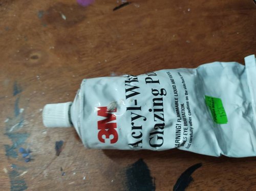

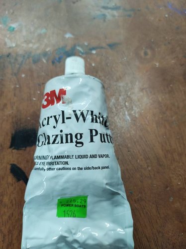

This Glazing putty was used for the joints/welds to give a smooth finish and to fill any voids that may exist.
Thanks for the advice
