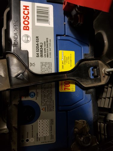

Postby Corn Bird » March 8th, 2023, 1:49 am
hover11 wrote:Anybody ever used BOSCH batteries, looking to try it next month...
I'm on my second Bosch which I'm looking to replace after 33 months. Previous Bosch lasted about the same. 2 liter Honda Accord. Will look for something larger, probably closer to 60 Ah.
I used to get 5 years life from those. On 2 cars.
Current ones just over 3 years old. No problem so far
