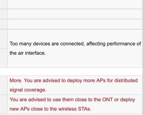

Anyone has slow wifi issues with the amount of devices on their network? What can you do to alleviate this problem?

eitech wrote:Anyone has slow wifi issues with the amount of devices on their network? What can you do to alleviate this problem?
How many devices and which router are you using?
I switched to a mesh system and it's working great - have over 30 devices on the network
Got the digicel router and about 30 devices myself
This is what the diagnostics says:
Re: Everything Smart Homes in Trinidad & Tobago
Postby maj. tom » August 12th, 2023, 2:49 pm
Get a Tp-link Deco mesh with a built in hub.

^ definitely need a mesh router system.
I switched to a TP-Link Deco X20 (AX1800) and it's been a great experience so far

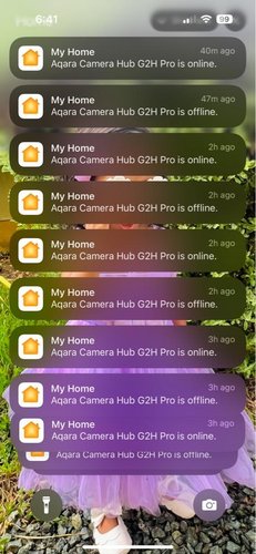

For the HomeKit guys
What yall using as smart light switches? I bought the Aqara camera hubs and security system and switches since there aren’t much no neutral wire options.
It works well.. when it works. But several times a day the Aqara hub would just randomly go offline for a couple mins. Happens about 20x a day. I did a factory reset n all. No improvement.
Any alternatives for no neutral wire smart light switches that compatible with HomeKit and has two and three gang options?
Also, unrelated. But the Apple Home app doesn’t work on my iPads or Mac anymore. It loads the app but it just shows up as an empty window. No devices. Nothing to click. Tried resetting those devices too. This going on for months.
Only the home app on my iPhone and wife’s iphone works.

scotty_buttons wrote:For the HomeKit guys
Very little options for good quality devices.
I have been using Lutron Casetta light switches - they are rock solid devices that never need resetting. I have them years now.
But you have to look for the no-neutral models and there aren't any 2 and 3 gang options.
Hopefully eventually Matter will fix this.
I've been looking at the Aqara M2 Hub and 2 gang switches for some places where I need it. I'm concerned now that you told me this. Have you tried getting another hub? Which Aqara hub are you using?
scotty_buttons wrote:Also, unrelated. But the Apple Home app doesn’t work on my iPads or Mac anymore. It loads the app but it just shows up as an empty window. No devices. Nothing to click. Tried resetting those devices too. This going on for months.
What's the model and iOS version on the iPad and Mac? Home was recently upgraded and don't support older versions any more. I'm actually delaying upgrading the Home app for that very reason.
https://www.theverge.com/23512574/apple ... ade-how-to
Unfortunately I don't think you can downgrade once you upgrade.
I heard so many good things about Lutron; looking at the blinds too.
I have two Aqara hubs. The G3 and the G2H pro. BOTH of which giving problems. Even after three firmware updates. Several forums show some users experiencing the same.
It’s more annoying cuz when one hub goes, the entire smart home is inaccessible. I always thought it’ll switch in between hub devices such as my HomePod or iPads but nope

I got a tp link wap and set it up in access point mode. I started migrating wifi devices one by one to it but when when i moved up to 10 of them, my router still says too many devices. I had to migrate most and then that warning came off.
So now i have four ethernet connected hardware connected to my router and all wifi devices switched to access point. Warning off and i have noticed an improvement already in video streaming.
