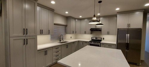

Phone Surgeon wrote:anyone got quartz countertops done in the last year or two?
whats the average price per sq ft to install?
also for spc/vinyl plank flooring, average price for installation?
Got my counters installed today actually. Cambria quartz 83 sq ft @ $433 per square ft.
Posts: 20002
Re: Building a house in Trinidad
Postby Chimera » November 5th, 2020, 7:40 pm
so like 36k for for 83 sq ft? labour and material?
blaine
Posts: 90
Joined: June 9th, 2008, 6:15 pm
Postby blaine » November 5th, 2020, 7:48 pm
Correct.
I must also say that it was a very good experience doing business with them. No headaches and job well done.
