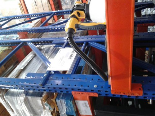

I saw this in price mart a while ago this one should be better for water paints and primer since the nozzle in the larger sprayer is wider.
Also I had messaged Wagner about the primer situation and this white one is what they recommended.
Postby Ted_v2 » September 25th, 2016, 11:15 am
Compressor separate from unit so seems Like a good buy.
It's a Wagner like what kripplerz posted
Strugglerzinc
Posts: 4043
Postby Strugglerzinc » September 25th, 2016, 11:16 am
Are nozzles interchangable on Wagners? Then it may just be a simple nozzle change for different paints?
Postby cinco » September 25th, 2016, 11:58 am
Is that 900 for the pricesmart one?

Postby kripplerz » September 25th, 2016, 12:36 pm
Strugglerzinc wrote:Are nozzles interchangable on Wagners? Then it may just be a simple nozzle change for different paints?
Sorry no the nozzles are not, the only upside is you can but the separate guns and attach to the same compressor.

Postby Ted_v2 » September 25th, 2016, 2:53 pm
cinco wrote:Is that 900 for the pricesmart one?
Yeah
Postby cinco » September 25th, 2016, 2:54 pm
Feel I go pick up one and see how it goes
Postby Ted_v2 » September 25th, 2016, 4:07 pm
I have a couple spray guns to use with compressors. I need a play with Them a bit more often. Cinco. I saw that same thing in allied for 1700$
