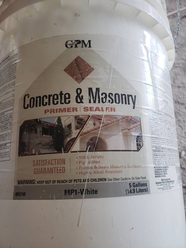

What is the go to concrete primer these days? One where you only need to apply one coat. I was told about the Trinity?
fokhan_96
Posts: 1827
Re: Building a house in Trinidad
Postby fokhan_96 » September 27th, 2020, 2:01 pm
I used Berger ALD. Its antifungus and thicker than the normal berger concrete primer.
shake d livin wake d dead wrote:What is the go to concrete primer these days? One where you only need to apply one coat. I was told about the Trinity?
Postby maj. tom » September 27th, 2020, 2:20 pm
PriceSmart has the 5 gallon Berger Contractor Primer.
Posts: 33215
Postby shake d livin wake d dead » September 27th, 2020, 2:53 pm
Thanks much...that's like 600 per bucket?
worksux101
Posts: 9760
Postby worksux101 » September 27th, 2020, 3:25 pm
I used SW loxon xp on the house and trying ppg sealer and primer at the moment on the perimeter wall.

Paid 840 for one of these in el socorro
Primer and sealer for new concrete.
