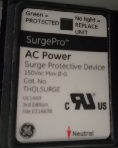

WTK Tank or Tankless Water Heater
Postby matix » August 11th, 2025, 1:07 am
For those whose panels have the space

matix wrote:Image
The white wire...goes to neutral or ground in the main panel?
matix
Posts: 2365
Re: WTK Tank or Tankless Water Heater
Postby matix » August 11th, 2025, 10:08 pm
Jerry84 wrote:
matix wrote:Image
Neutral bar
