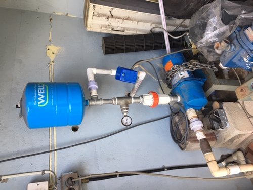

200sx wrote:recently installed a 1HP GOULDS pump with 30/50 switch and a 2gallon pressure tank.........the tank is way to small for the pump............ i know, when they say a 2gl tank its really .6 gallon of water the tank accutally holds (the rest is air this pressure should be set 2PSI lower than your cut in pressure) so every time you use .6 gallon of water the tank empties and the pump trips on.......this is bad for the motor espacially while bathing the .6 gallon from the tank empties quickly.........avg 12-15seconds.........so my pump trips on and of being a 1HP MOTOR........ i need to maintain a flow rate of 24gpm.......... so fellars when choosing a pump bigger isnt always better............i will be supplying water to 5 full baths, plus........kitchen etc......so i wanna convert my 1HP goulds pump to run like a smart head........ by using a Pressure Reducing Valve (PRV) and moving the pressure switch from the pump, installing it in front of the PRV............i know i can just put a smart head unit on it............but i want to try another way..........will be updating........
I know you already bought your fancy valve, but wouldn't a larger tank cut your cycle times down?. Your pump response in filling the small tank while in use would cause it to cycle fast, because unless you open all 5 showers to max that pump once running will go past 30psi and hence the issue. So please do update us to how the unit you bought works out.
daron

pugboy wrote:$70usd or TTD eq
https://www.ebay.com/itm/CYCLE-STOP-VAL ... ctupt=true
it is a 60psi version, so you need a 60psi cutoff pressure switch i think.
you still need a pressure tank but can use the smallest one, it will be stressed less as less on/off cycles
It has to be installed before the pressure tank, ie between the pump and the pressure tank.
it does run the pump a little more like a smarthead but it throttles the volume pressure at 60psi max so pump will be running in a steady state with less current load than a pump running with full bore volume flow.
Cycle stop valves are great for installs with many users/bathrooms where a large pressure tank would have to be used
however pressure tank prices go up exponentially.

Yep 1 1/4” inlet with 1” poly out no 90* bends.......smooth bends with the poly for abt 20-30 feet then break down to 3/4”...........
Supply 1000gl tank and 400gl linked
I researched buying a bigger tank.......... say I bought a 20gl tank.......on avg it’s 2/3 air pressure 1/3 water which gives me avg 6gl of water discharged from 50psi to 30psi before the pumps trips on then back up to 50psi............ that steady pressure drop from 50-30psi will be noticeable hence the purpose of the “fancy valve” having a pump running is better for the motor than the start stop.........
This valve senses when there’s more than 1gpm flow and more or less fools the pump by causing a steady back pressure not harming the impeller of the pump causing it to keep running until the water is shut off which allows the pump to build back up tank pressure to the set 50psi
It’s a mechanical smart head set up more or less
I’ll let u’ll know abt the valve........should arrive next week.........

200sx wrote:Yep 1 1/4” inlet with 1” poly out no 90* bends.......smooth bends with the poly for abt 20-30 feet then break down to 3/4”...........

pugboy wrote:remember to put pressure switch after cyclestop valve and pressure tank.
Mine is a 40psi
and pressure switch 40/60
so with multiple taps open, it will keep pump running but choked to 40 psi
if only one tap the volume runs it up a little higher like 50 but constant and only when tap closed runs up to 60 then switches off pump.
generally taps run at 45-55psi on avg rather than swings between 40-60 many times with start stops
What breed of pump is that. Large chain required.

pugboy setup looks very correct from what im seeing.
