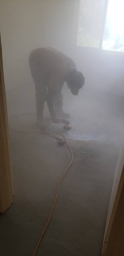

DASSMASS wrote:na want it grind off or stripped
if it's outdoor pressure washer,
if it's indoor & a single room with a way for the water to run out the room to the outside of the building it could pressure wash as well.
if not either u could use a paint stripper (will likley leave residue in the concrete, not sure how it'll affect the bond in the short/long term depending on what you use, glue vs thinset)
or simply scrape it off with a scraper
or a grinder with a concrete cup wheel (fastest easiest method I've personally ever used, a bit noisy, makes plenty dust, isolate the room first if you can)

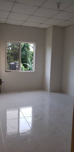

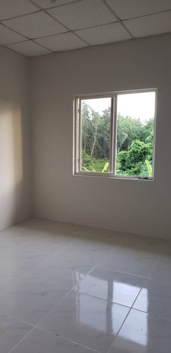

Postby DASSMASS » November 1st, 2018, 8:43 pm
Some of the finished Product EXCELLENT WORK
hong kong phooey
Posts: 3001
Location: ah lorse
Re: What is a fair labor price to tile 1087sqft?
Postby hong kong phooey » November 2nd, 2018, 3:13 am
Nice, no burglar proof windows, must be country living
You should have gotten the guy to put a tile border so when mopping the mop will not touch your paint
