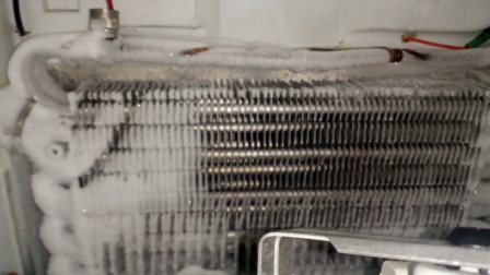

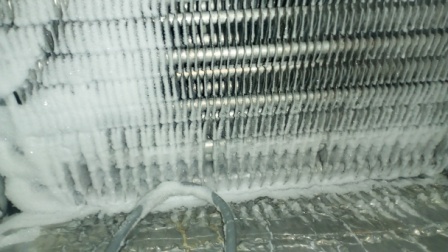

Postby daring dragoon » April 22nd, 2020, 4:58 am
now take a pic. this was cleared of ice yesterday about this time and this is it now. any suggestions? is the silver looking canister thing the defroster that has to change?

Postby daring dragoon » April 22nd, 2020, 6:34 am
so i did some testing recommended from youtube and it seems the defrost timer is bad. is there a universal timer that i can use as i think consol is closed down and idk if parts are available.

Icing is usually with faulty temp control and leaks.

Postby daring dragoon » April 22nd, 2020, 1:55 pm
i put the defroster switch to defrost and the defroster came on. i replaced the switch so lets see what will happen
