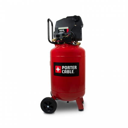

what about this from pricesmart ? i think its about $2000, it a 20lb tank about 90lbs. any reviews on this from anyone

Postby Strugglerzinc » January 23rd, 2020, 10:21 am
Haven't used that particular one but have had similar. They are great for light duty home use and will run almost any low to mid cfm air tool. I have even painted with one and it was mostly fine.
Be warned, they are noisy a.f if that is a consideration as they are usually oil less.

Postby daxt0r » January 27th, 2020, 4:47 pm
ah went pricemart today they only had only da look about 3 times d size of that one in the pic above but was plenty more money, i think i saw it for 8000 or so.
