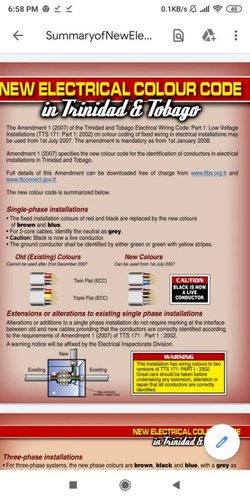

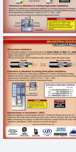

Postby Gladiator » May 3rd, 2020, 6:54 pm
Print this and keep it too... Note section on single phased installations
adnj wrote:
Gladiator wrote:
adnj wrote:There were just 20 posts about whether the blue was neutral or not. :)
Yeah I know... my advice is to follow the local TTBS colour code. Appliances not meeting the code should be reported to them for non-compliance. It could be dangerous to people that don't know better.
I keep a copy of TTS 171 at my office. Blue is only mentioned for third leg 3-phase AC. The local EIG Rhino cable color code is made to EU/IEC standards, not TTS/NEC. But I suppose that is moot. You just need to wire it correctly.
Download Higher Resolution here: http://www2.ttconnect.gov.tt/gortt/wcm/ ... OD=AJPERES

Postby Gladiator » May 3rd, 2020, 7:01 pm

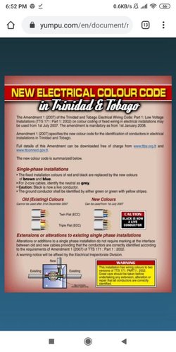

Reposting...
Re: need help with a shower heater
Postby adnj » May 3rd, 2020, 8:18 pm
Gladiator wrote:Print this and keep it too... Note section on single phased installations
adnj wrote:
This was something that was talked about when it happened in 2008. The revised low voltage TT standard didn't mention using blue as a neutral conductor - not even as an option.
In general, I believe that it's of little concequence. But if it's there, I didn't see it back then. No one that asked me about it could find it either. It may be in the 2015 revision but that doesn't explain the 2008 direction. Maybe it's just group blindness. Maybe it was a misprinted standard (WTF!).
If you can find it in TTS-171 2007/2008, let me know.
