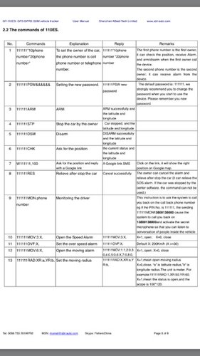

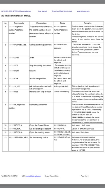

innovative audio wrote:Guys I have a gps experts tracking device in my car as well. I was able to find out about the company that makes it and I got ahold of a manual for it and operational codes for it. I would be willing to help u all out. As for topping up I have no probs and I could help u there as well
Thanks bro I can't remember half of them codes how can I get a copy or as a matter of fact what's the name of the company

so after watching the list ... my text always come back as " unit disarmed" so does that mean i should arm it ???
1/4 mile king
Posts: 87
Joined: August 10th, 2008, 2:53 am
Re: GPS EXPERTS: Operational or not
Postby 1/4 mile king » September 25th, 2015, 7:48 pm
No.. U only arm it when u need to. Like parking in a mall or movies etc.. Do all the commands u send it replies with ' unit disarmed '. ???? If so then something is wrong.
