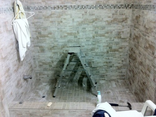

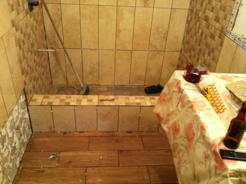

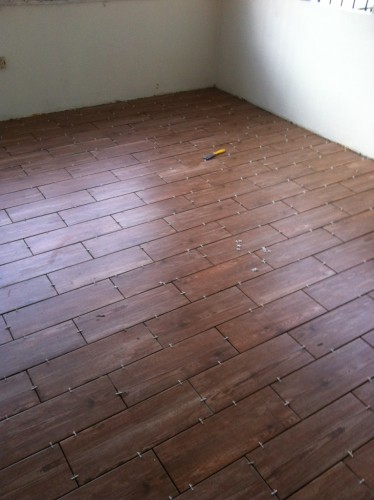

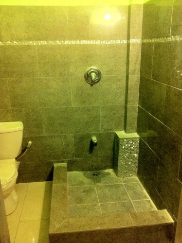

I'm ah tile man and these are jus some of the jobs I have done people don't be fooled tile work is no easy work eh!

leondlln1 wrote:Image
This is a tile?
Posts: 17908
Re: wtk: tiling
Postby De Dragon » March 12th, 2017, 8:25 am
This is a tile?
Yes, bigger tile places have them in curved or rectangular sections
