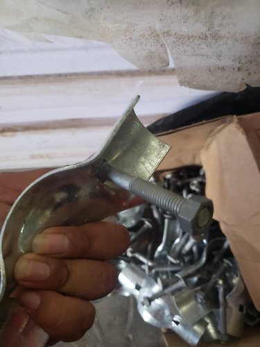

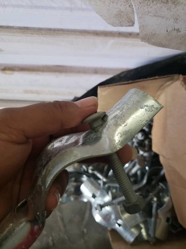

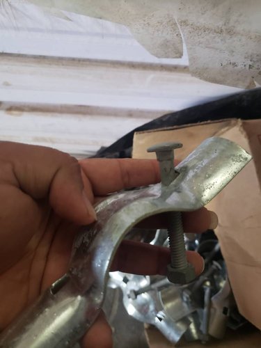

i eh lying to tell you i spend $1600 labour plus $600 for auger to put down posts for 200 feet of fence and run razor wire ontop
2 days work
34 galvanize posts
2 rolls of chain link
and two galvanize pipe cross bars, top and middle
i used line rail clamps instead of welding though
so everything move much much faster.

Re: Building a house in Trinidad
Postby adnj » July 31st, 2020, 1:10 pm
Phone Surgeon wrote:i eh lying to tell you i spend $1600 labour plus $600 for auger to put down posts for 200 feet of fence and run razor wire ontop
2 days work
34 galvanize posts
Were you able to find the rail clamps locally or did you decide to ship them down?

Yes trinrico in reform sells it for like $12

better to use the clamps as most welders make a mess of welding tube sections together

Phone Surgeon wrote:Yes trinrico in reform sells it for like $12
How are those clamps fastened to the pipe?
Postby adnj » July 31st, 2020, 4:15 pm
You can use the same clamp for tents and canopies.

I think $1.50 for a nut and bolt right by trinrico. I have two milwaukee m12 impact drills so these things bolting up in no time.
NR8
Posts: 1872
Postby NR8 » July 31st, 2020, 4:28 pm
Ahh nice. Thanks
