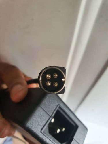

Postby supercharged turbo » April 22nd, 2022, 10:15 pm
Where can I get a power supply with this tip?Everywhere I look so far don't have it
