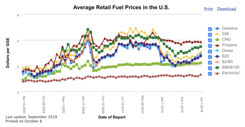

Is CNG subsidized at the cost of TT$1/litre? If it is, what is the market rate? What is point of government incentivizing motorist to move to another subsidized fuel? Won't we end up in same place we are right now with the liquid fuels?

mazdatt
Posts: 132
Joined: November 12th, 2009, 10:33 pm
Re: THE OFFICIAL **ALL THINGS CNG** THREAD
Postby mazdatt » October 8th, 2018, 12:44 pm
Based US pricing Gasoline is $2.88/gallon and CNG is $2.22/GGE so CNG is most likely heavily subsidized here.
If gasoline is $4.97/litre then CNG should be around $3.8/litre
From experience with a hybrid (Ioniq) I was able to use 50% less gas so that might be a better investment until electric cars are more affordable.
Source: https://www.afdc.energy.gov/fuels/prices.html
