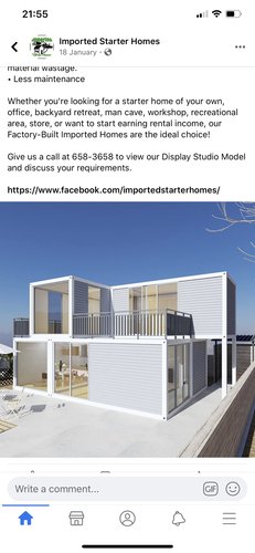

they offering built up houses for sale off cunupia
Re: Building a house in Trinidad
Postby rspann » March 5th, 2020, 7:09 am
Yeah , Welcome Rd. They did some for HDC in Wellington Rd Debe too .

I'm seeing these at the 400k range

tr1ad wrote:I'm seeing these at the 400k range
Never heard of this! I wonder how durable these are. Also, that’s a lot of glass. Is it safe to have in Trinidad?

Long term it’s better to go with traditional building methods. The prefab houses still need a foundation to be built on. Labor is a lot less with the prefab houses once the people putting it together knows what they’re doing. We’ve done work on quite a few and it’s all different. The ones on Taska road that spann spoke about are very small but went up quickly and I think they used concrete board mostly. There’s some where it’s a styrofoam material between 2 metal sheets and those go up really easy because it just fits onto a frame and that’s it. It comes as a 20ft container or 40ft, depends on your preference. There are others that I worked on with styrofoam and concrete mixture. Went up the same way.
It's customized from what I understand, I'll be checking them next week to look at quality, understand how it ties into the foundation, durability, warranty etc
Postby rspann » March 6th, 2020, 12:10 pm
$400000 could be spent better than that.

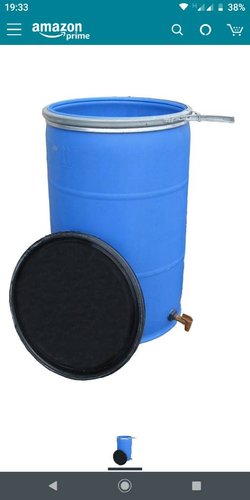

This is probably the wrong place to post, but I'll ask anyway.
Where can I get plastic barrels? Need a couple for water storage. Preferably those with the full diameter lid and not the ones with the two holes with plugs in them. And not the tapered ones with the screw top either. Basically something like what's in the picture minus the tap at the bottom.
What's an approximate price I can expect to pay for one?

Like this.
