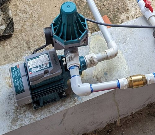

^ I bought a 1/2 H/P Total Smarthead pump and installed it last month. Same as you..flat house with 1 Bathroom (soon to be 2 though). Apart from that its maybe 4 other taps in total. I am getting good pressure at all the outlets.

total is peripheral type ?

Not sure nah.
The pump below
pugboy wrote:total is peripheral type ?

yeah that is a peripheral type, they move a little less volume than the the centrifugal type but work for small installs like yours.
they seem to be working well judging by the amount being sold on the market and cheaper than traditional pumps.
the early pentax smartheads used to burnout, not sure if they still do but seeing plenty cheaper smarthead replacements on the market
