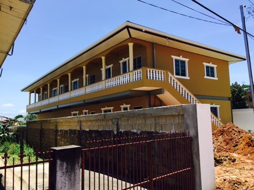

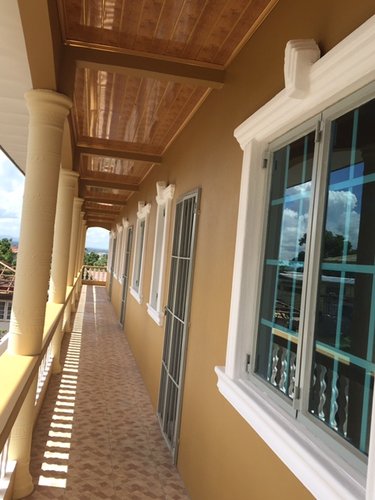

Re: Building a house in Trinidad
Postby rspann » November 19th, 2015, 6:27 pm
Build 8 apts ,live in one. The income could pay any mortgage, save to build a house after.

Postby kjaglal76v2 » November 19th, 2015, 6:39 pm
beautiful

Postby The Raven » November 19th, 2015, 8:34 pm
Rspnn, what is the size and pound of your metal post?
Thanks.

Postby rspann » November 20th, 2015, 5:26 pm
The Raven wrote:RSpann, donot forget my question,
What side is the post 8x8 by what pound?
8"x8 " ,31 lbs (W 8 x31)

Postby The Raven » November 20th, 2015, 7:36 pm
That's the same specs as mine. Thought mines was under sized.

Rspann,
Did you used foundation blocks for the first floor?
Postby rspann » November 22nd, 2015, 12:29 pm
No, Hollow clay, but all corners and all the way up the posts have 1/4 " rods welded in to tie the blocks to the posts,and all corners cast right up to top floor and a beam at lintel/ door height, from post to post. I did other buildings with Concrete blocks though.
