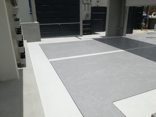

I prefer a clean finish. There is concrete there right now, but it is pitted and spalling, no cracks though. I would prefer NOT to have to break it up (which I know is what I will have to do to use the pavers since it is currently flush with the garage (epoxy floor).
The Crete-Art horizontal overlay option looks more like what I'm looking for.
Has a modern look too, which I like.
From the crete art website

Can't see a micro-topping costing more than digging out the existing concrete, casting a border, compacting sand and installing pavers.
carluva
Posts: 1993
Re: Building a house in Trinidad
Postby carluva » February 3rd, 2020, 6:34 pm
I had a similar issue Duane. I am looking for one of my previous posts but can't ATM.
Anyhow, do a screed mix on top the existing concrete. You can easily go as thin as 1.5" with a screed.
I did mines with Coosal's a few years ago. It was a sharp sand, 3/8" aggregate mix, with fiber reinforcement. I troweled finished but I will advise a power float finish. If your existing surface is sound(ish) it will need to be pressure washed, etched and then primed with a bonding agent prior to pouring the mix. If you have cracks, deal with those by channeling open the crack and then filling with an epoxy joint sealant. Once you are done with the pour, cut a few control cracks on the fresh floor.
The end result is a superb floor that can take the weight of vehicles, and with a finish that will be ideal for tiles, acid wash, epoxy or decorative concrete.
Crete art is nice but be prepared to fork out muy dinero. You can also check SCL as they have some decorative options.
