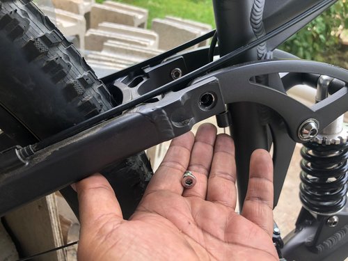

Posts: 23909
Re: Mountain Biking
Postby MG Man » May 23rd, 2022, 9:15 am
Still doing Chaguaramas trails when I have company
Also, for all the other nOObs in the ched, the other pic underscores the importance of regular inspections
Luckily that bolt fell out in the car on the drive home, but clearly it was on the verge of falling out on the trail
So loctite is on the shopping list this week
Posts: 16828
Re: Mountain Biking
Postby VexXx Dogg » May 23rd, 2022, 4:43 pm
MG Man wrote:Still doing Chaguaramas trails when I have company
Yea, I almost had a clusterfuck of an accident due to inexperience with that kinda riding.
Had a hardtail specialized and the front fork was quick release with a dropout axle.
I was riding down the last big hill in gran Couva (tower descent into la Vega( when I heard a strange clunk in the front.
I stopped to realise my QR was completely loose and as soon as I lifted the front the wheel dropped out.
I coulda wipe out bad.
Learning moment there is always inspect before every ride, even if it's the night before. Check tire pressures, look for any embedded debris,. make sure axles are snug, shifting is smooth, chain lubed etc. Don't forget to have some tools and spares handy too.
