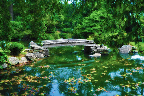

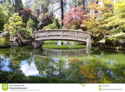

i looking for some ideas to build a bridge over a pond.
about 25 feet across
any suggestions?
beautiful-landscape-picture-small-wooden-bridge-over-pond-japanese-garden-reflection-water-121429094.jpg

Postby adnj » September 30th, 2019, 4:00 pm
You will start with determining what your live load will be, desired width and height over the water.
A beam bridge will be the most cost effective for foot traffic followed by a truss bridge for vehicle traffic.
Your photos both show landscape beam bridges.
