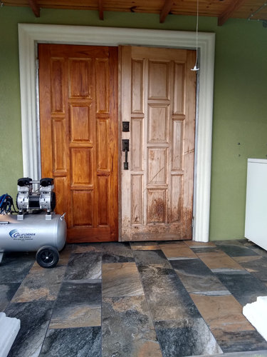

Refinishing some doors I put off about 2 years now.

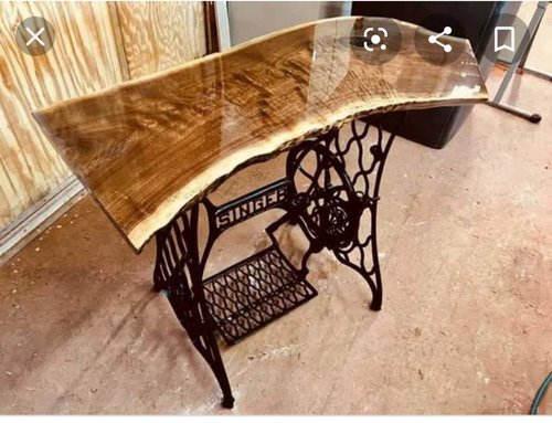

Starting on a Sewing Machine stand live edge side table..sent the stand to paint, and starting on the table top tommorow.
Would post the progress.

sewing machine tops looking good

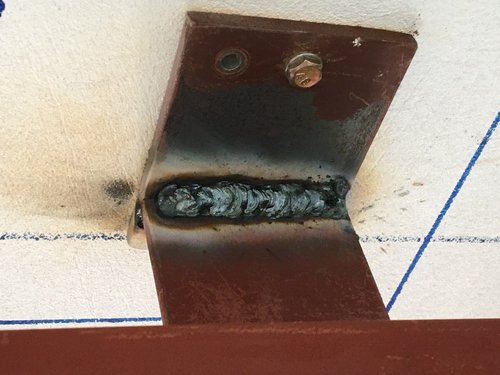

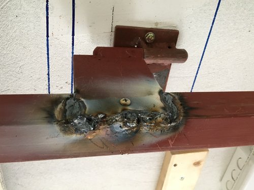

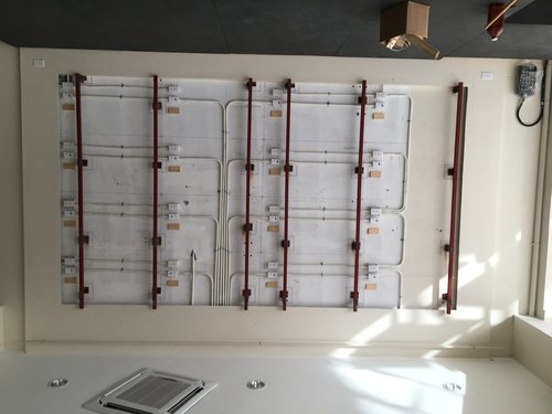

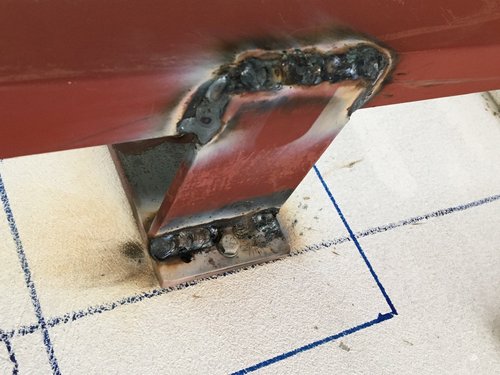

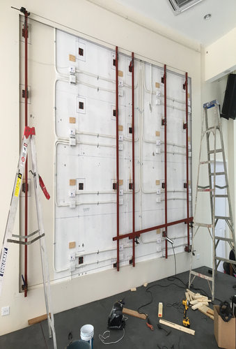

job is a 16x9ft video wall cinema screen.
using 16 48” video screens in a 4x4 pattern.
each screen and mount is about 90lbs
finished the main work of the vertical supports plumbed up. 1.5” rhs welded to 1/4” plates bolted to concrete wall.
the screen mounts will bolt to 1” rhs horizontals.
waiting to get the mounts before that stage.
use almost a whole box of rods so for this.
first few pics upside down.

^^^ You using 6013 rods, 3/16? 90amp?
Might be draging the rods a lil slow.

a little hotter to make sure the 1/4 wet.
it’s a pain welding 1/4” to rhs 1.5mm

I stopped using arc on anything RHS, I use flux core mig. Arc on rhs is a pain to weld.

u probably already know this : when welding 2 metals of different thickness u focus more of d weld on d thicker metal & a bit of stop n go method helps keep d heat from burning holes in d rhs too ..

my body real sore and stiff today after that 4 hours of welding in diff positions on a ladder all how

I'll give you credit for running all of that conduit.

Nah a bonafide electrician do that.
