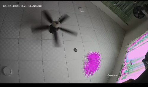

What causes this pink colour? Night mode works well. I suspect its the ir LEDs. Settings not helping. I scrap down the camera and aint find anything of note.

Could be light shining off something outside? I see a few times when car park outside the window. From a hidden wall camera though.

I had an extra camera i wanted to install. It only appears around bright sunlit areas and on this camera alone

Then it probably faulty like mine, if it's an one-off experience

Postby eitech » May 16th, 2021, 10:53 am
viedcht wrote:Then it probably faulty like mine, if it's an one-off experience
eitech wrote:
viedcht wrote:Could be light shining off something outside? I see a few times when car park outside the window. From a hidden wall camera though.
Yea i suspected as much. Couldnt find the damn warranty bill too and now this lockdown.
