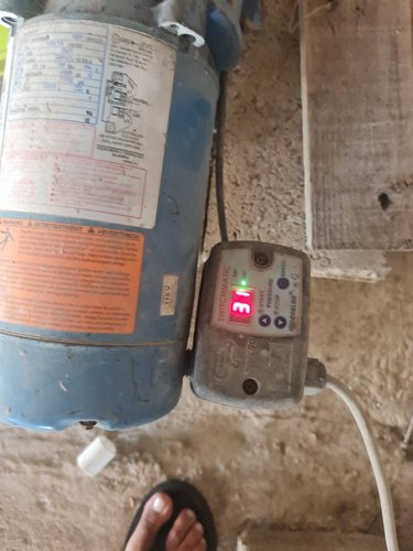

The issue I have with smart heads is they turn on as soon as you open a pipe.
If u just rinse your hand or brush your teeth or full a dog bowl the smart head kicks on.
Multiply that for everyone in the household.
A 20 Amp or saw draw every time it comes on
I set my pump to 40/60 but I have that pump running some drip irrigation as well with psi regulators.
So I could do with a constant 50 or 55 psi pressure rather than having to deal with it dropping to 41 42 48 etc....
That's my reasoning for the cycle stop valve. With the pressure tank

Lemme ask something..
In my situation my 5 gallon tank has a digital pressure switch which I have set at 40/60. I can see the pressure counting down when I open a pipe....
So I can see if I open a pipe to wash my hand...it count down from 60 to 57.....open again....57 to 53.....again.....53 to 49......pump never activates during that time because it doesn't need to....
So several times I can open pipes for small tasks without the pump activating....
Now I have different drip irrigation attached to my pump....different sections.....
As it is now I can only open one section at a time because if I open two it won't get enough pressure.....the pressure will be around 45/48 and won't build up past that because of how fast the water is being used.
Wouldn't the csv in my case give me constant 55 psi pressure all the time.....
I assume that a constant 55 psi pressure means the pump will come on much faster and frequent if using for small tasks?
But if using for bigger tasks like running 45 mins drip irrigation....I would get my constant 55 psi ( with a csv valve set at 55 psi) ?
Posts: 29389
Re: Which residential water pump to buy?
Postby pugboy » March 15th, 2023, 9:30 am
if with multiple section open and your pump running, you only seeing 48psi then that is all the pump is capable at pushing with the demand of those multiple sections open
so with a csv you would still be limited to what the pump could push
Supra GT-FOUR
Posts: 255
Joined: April 30th, 2004, 10:46 pm
Location: Mango Tree
Postby Supra GT-FOUR » March 15th, 2023, 9:35 am
cornfused wrote:Tried and Test Pump and Tank systems are the best
I am not sold on CSV because of the following
1. The leave a longer running time for the pump and using more electricity. A lot of bull out there to counter that point
2. The design of the CSV seems to be a modified PCV pressure control valve or a PCV with a leak
3. More pump starts , the CSV with small tank will start the pump frequently less cycles , look out for water hammer
4. A variable frequency drive VFD seems to be better with softer starts.
VFDs are used on 3 phase motors and usually require 3 phase supply.
Some can run on single phase 220v (the VFD creates a 3 phase output from the single phase input).
All domestic pump motors are single phase (usually 110v).
Posts: 20049
Postby Chimera » March 15th, 2023, 9:42 am
pugboy wrote:if with multiple section open and your pump running, you only seeing 48psi then that is all the pump is capable at pushing with the demand of those multiple sections open
Wouldn't the csv create a back pressure that pushes the constant 55 psi (that I choose) u ever check out the interactive demo on csv website
Posts: 29389
Postby pugboy » March 15th, 2023, 10:08 am
it’s possible but not sure
is this an existing system?
i think i have an extra csv if i can find it
Posts: 20049
Postby Chimera » March 15th, 2023, 12:13 pm
Yea it's a system I have now.
I using one goulds pump to run my house water as well as drip irrigation for about a acre of citrus
Posts: 20049
Postby Chimera » March 15th, 2023, 12:20 pm
Actually only getting 31 psi when one of the bigger irrigation zones open
