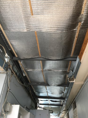

Postby pugboy » May 23rd, 2019, 4:47 pm
Installed radiant barrier under a shed we have
It was put in after the roofing was installed.
Makes a huge difference, night and day.
