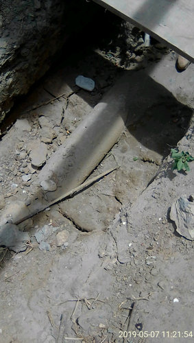

Best septic tank/soakaway. :D
Re: Building a house in Trinidad
Postby rspann » May 8th, 2019, 7:59 pm
I don't know if it showing properly, but its the concrete line that goes to wasa's sewer system. No problems ever
