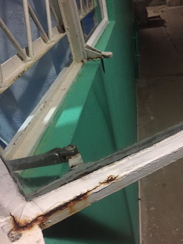

Would post a pic later but my question is: i notice that on some of my windows (outer), there is a resin that keeps the window glass in d frame. This forms a border. It is cracking up. What can i do to fix that?

eitech wrote:Would post a pic later but my question is: i notice that on some of my windows (outer), there is a resin that keeps the window glass in d frame. This forms a border. It is cracking up. What can i do to fix that?
Resin or steel putty? if it's steel windows it's putty, dig out and apply some fresh putty.
it cracked and came out real easy. Almost look like a wooden texture. Whatever i putting back i may wanna paint as well. What kind of putty to ask for?

eitech wrote:
Steel putty. It;s mixed to a semi-soft consistency using linseed oil. Apply with a putty knife at a 45 degree angle and it looks real good. When it's dry after a week or so, clean the residue on the glass using a blade and glass cleaner. Don't touch it before to see if it;s dry,

That is likely the plastic border that is called a retaining strip or a glazing bead. If you can get a suitable alternate, remove the bead and replace it.

adnj wrote:That is likely the plastic border that is called a retaining strip or a glazing bead. If you can get a suitable alternate, remove the bead and replace it.
It sounds like it's those local steel tubing windows with putty and not prefab aluminium/ PVC windows since he said it's cracking. Perhaps he could clarify.
Re: Building a house in Trinidad
Postby rspann » March 21st, 2019, 8:09 pm
Yeah, that's steel putty. It will come out easy. Dig out as much as you can clean properly, paint on some rust treatment like red oxide, put on new putty and paint when dry. If you get a good rotary wire wheel and some coarse sand paper those windows will come back like new.

eitech wrote:
rspann wrote:Yeah, that's steel putty. It will come out easy. Dig out as much as you can clean properly, paint on some rust treatment like red oxide, put on new putty and paint when dry. If you get a good rotary wire wheel and some coarse sand paper those windows will come back like new.
My response must have been slow...
That is just your basic window glazing compound (window putty). You can pry out what is loose and use a heat gun to soften what won't come off easily.
Like rspann said, your windows look as if they are rusting so scrape and brush off the rust where you can, treat with phosphoric acid (Wonder Plus, etc.), paint with oxide primer, and then apply the glazing compound.
You need to paint glazing compound when it's dry to prevent early cracking. There's lot of info on what to do and how to do it on the web.

Postby rspann » March 21st, 2019, 8:21 pm
Hummingbird brand linseed oil putty is a good one and doesn't need softening. It dries hard in a week if the weather is good.

rspann wrote:Hummingbird brand linseed oil putty is a good one and doesn't need softening. It dries hard in a week if the weather is good.
Got this in hardware yesterday. So i clean out old rust, red oxide prime, then apply putty? Once cured, what’s d preferred paint? Oil or emulsion?
Postby rspann » March 23rd, 2019, 8:05 am
Never use emulsion on metal, it will cause more rust. Use oil, or there are types of latex that are made for metal. You get these at Benjamin Moore Sherwin Williams etc , but they are verrry expensive. I paid around $800 for a gallon. If you put on enough coats of oil paint, especially if rain hits the window, you won't have any problems for years. I just remembered, misra paints has a water based for metals, and it's not as pricey.

rspann wrote:
Yea i actually had gotten d oil paint already, a cheap quart for now
