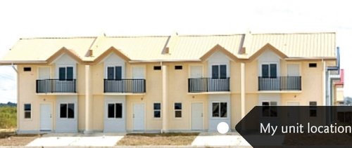

Its for a town house spans accross 19 feet my unit is 1 in the middle.
2 car parking

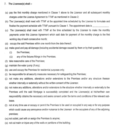

Read your deed/rental agreement with HDC bredda, there are usually 3-4+ pages of covenants which detail what you can and can't do. Some can be easily broken without a care, but this wont be one of them.

From a very quick search of some documents i have laying about.
First is a rental agreement for a HDC townhouse, second is a clause from an HDC sub-lease for vacant lands sold to a separate owner.
Now, this being a townhouse makes it different from a single family detached house, I wouldnt chance it.
HDC sub-lease covenant.PNG (37.54 KiB) Viewed 4822 times
This is not my townhouse just reference didn't say it was hdc nice information being shared
Well if is not HDC, its even worse. Especially if its in a development that requires you to pay a service charge, association or maintenance fee monthly.
If is a gulf view villa then you safe, everybody in there have a shed/garage now.
