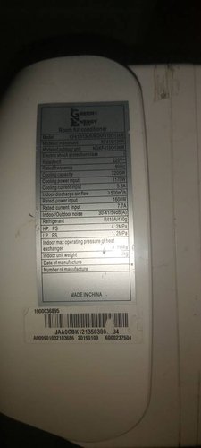

Postby Jerry84 » April 8th, 2024, 6:15 pm
This is the sticker on the unit with the specifications.
Re: What the Best Split level AC Units...Carrier LG, Panasonic?
Postby nervewrecker » April 8th, 2024, 9:55 pm
Continental. Have a branch in couva and princess town. Use google maps
