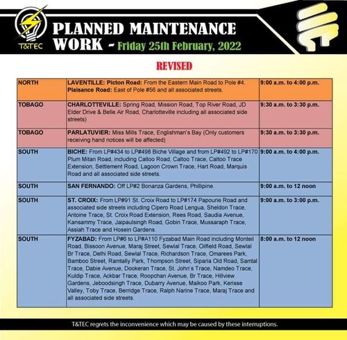

gastly369 wrote:. IMG-20220224-WA0337.jpg
Another link.
https://ttec.co.tt/default/scheduled-interruptions
Re: Residential Generators
Postby gastly369 » February 25th, 2022, 7:24 am
With this weather I feel dey might cancel
