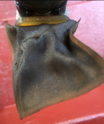

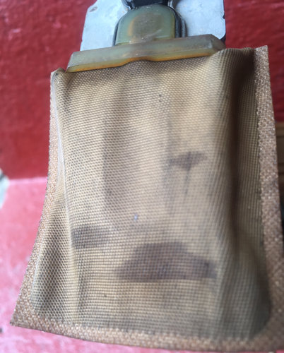

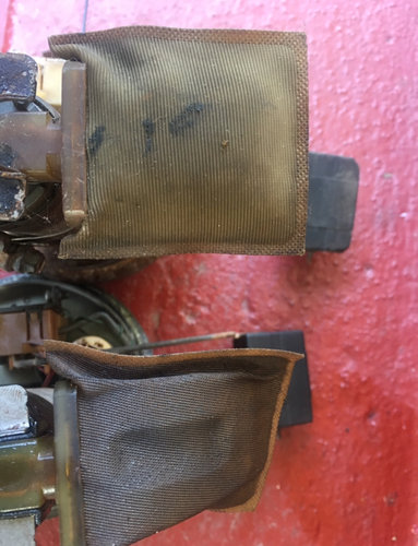

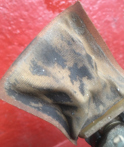

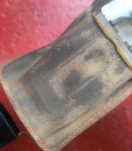

About 2 weeks now my car idles bad shuts down while waiting at lights, engine stutters while driving after driving for over 1 hour. I thought my brain bad I switch it out same thing so I conclude pump was going bad.
In my car Mitsubishi normally sends 6v to the pump during normal driving so I thought if pump going bad might as well hit it full 12v all the time. Did that and car idles perfect. So I thought temp quick fix wukking. But after doing that the car starts sputtering again after 30mins driving and cuts off at lights again so I say well boy pump dying.
Pull it out this morning to install spare just to see my tea bag filter clogged to the max.
Using super Gas.... NP the gas it Not good

What was the sedimentation in your tank like?

Dave wrote:What was the sedimentation in your tank like?
Didn’t dump tank yet. But I can just barely see the stuff that clogged the tiny holes in the filter when I disturb the fuel with a screw driver.

After dumping, refilling tank and driving around for 2 days. It’s looks and feels like a fine powder

I have avoided an opinion on our fuel quality since closure of Petrotrin until more evidence was available.
At this time I am convinced that Paria and NP are not holding firm on quality stds for imports of fuels and things have gone haywire.
Vehicles where full tuning services are executed are not holding and customers are quickly experiencing fluctuations in idle and power delivery which of course impact on shifting, engine operating temp and even AC function.
Unfortunately, if the present situation continues failure of sensors and internal engine components seem to be on the cards.
This particular situation is really the silent slow killer of your investment.
