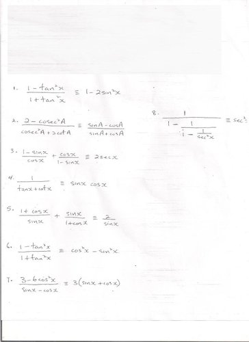

Try this one :P

Ronaldo95163
Posts: 8393
Location: Not quite sure
Re: ||| - Official Maths / Science Thread - |||
Postby Ronaldo95163 » March 18th, 2012, 12:30 am
Last identity givin me rel stress dan.....idk if I doing something wrong and I not seeing it but I just aint gettin the answer >.<
Corn Bird
Posts: 301
Joined: July 12th, 2011, 2:45 am
Location: captivity
Postby Corn Bird » March 18th, 2012, 12:45 am
gracen wrote:Try this one :P
given identity does not seem correct. this is what i get
try substituting x=45 degrees. then left side of your identity gives -1.
Ronaldo95163
Posts: 8393
Postby Ronaldo95163 » March 18th, 2012, 12:58 am
Yea I think there was an error in the question
#8 is the question

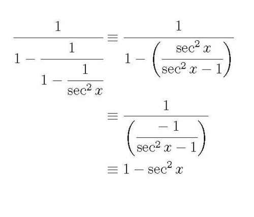

I got someone who proved the identity @CornBird.....when I get time ima post the solution

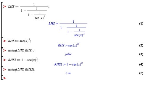

gracen wrote:I got someone who proved the identity @CornBird.....when I get time ima post the solution
i checked the identity with some software. according to the maple command 'testeq', the identity as given is false. my answer above of 1-sec(x)^2 seems to be correct

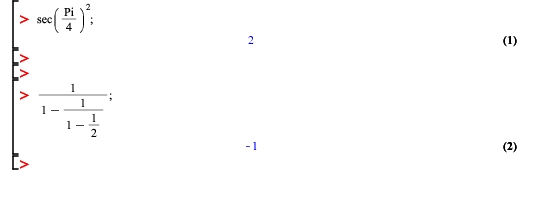

gracen wrote:
dr gracen, it isn't too hard to check if an identity is true or false. these trig identities usually hold for all values of x. notice that this one does not hold for when x=Pi/4= 45 degrees. for x=Pi/4, we have sec(x)^2=2. but the lhs is equal to -1.
Untitled (2).jpg (11.6 KiB) Viewed 1957 times
this gives an indication that the identity is false.
