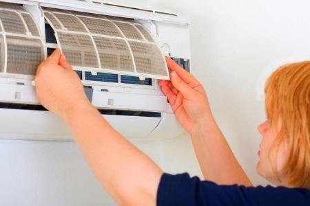

R.P.J wrote:Guys I now see dis thread dis is tje ac unit I have an its leaking water on the inside piece by the right hanf corner vent. Anybody have this unit.
the drain pipe is probably clogged. Have the unit serviced.
a quick DIY fix for that is to remove the filter, wash it out, pour a little bleach over the metal fins of the evaporator, wait a while and then replace the filter - that will clear the clog and stop the dripping inside.
the metal fins are behind that filter the person is taking out in the photo:
OH My Duane giving AC advice :o
