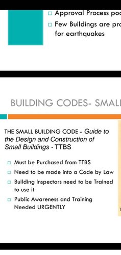

Good day can someone direct me to where I can get the rules and regulations building codes for Trinidad and Tobago. The ones town and country abide by. Can it be gotted anywhere online? My search has been futile so far.
Thanks in advance

Postby Strugglerzinc » December 15th, 2018, 10:36 pm
Second result in Google. Second.

Postby cutthroatInt » December 15th, 2018, 10:38 pm
Strugglerzinc wrote:Second result in Google. Second.
I apologise for my ignorance but please copy and paste the link you are referring to.

Postby Duane 3NE 2NR » December 15th, 2018, 11:53 pm
http://chamber.org.tt/wp-content/uploads/2011/07/Building-Codes-and-the-Regulation-of-the-Building-Industry-2011-Mark-Francois.pdf

Postby cutthroatInt » December 16th, 2018, 4:05 am
So there is non online then. Have to buy from ttbs. Thanks
Re: Building a house in Trinidad
Postby adnj » December 16th, 2018, 5:37 am
This is the draft on Scribd. The final version is what you will want to buy. The cost for any of the standards is fairly reasonable. The hardest part is getting there.
https://www.scribd.com/doc/20748625/Trinidad-Tobago-Small-Building-Code-Draft

Postby fokhan_96 » December 16th, 2018, 12:08 pm
cutthroatInt wrote:Good day can someone direct me to where I can get the rules and regulations building codes for Trinidad and Tobago. The ones town and country abide by. Can it be gotted anywhere online? My search has been futile so far.
Thanks in advance
https://ufile.io/r36wg
A pdf of the document can be downloaded at the above link.
