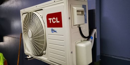

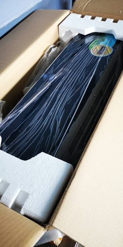

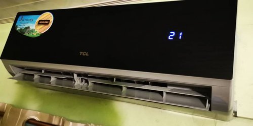

Postby gastly369 » December 10th, 2021, 7:28 pm
Installing up tmrw let's see how it goes

Postby Dave » December 10th, 2021, 7:37 pm
Can you see the make of the compressor?

Dave wrote:Can you see the make of the compressor?
I'll check tomorrow but it should be hitachi if not mistaken

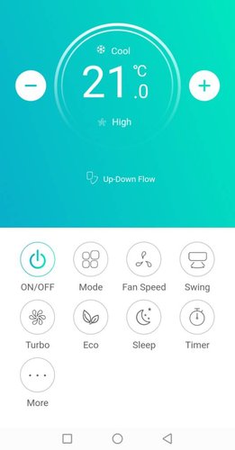

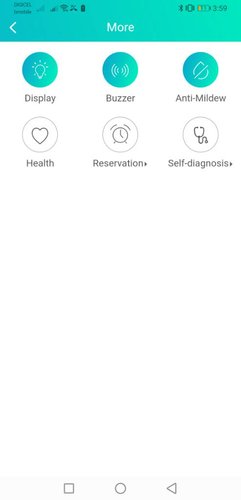

Postby gastly369 » December 11th, 2021, 4:02 pm
Edited Toshiba compressor
Working sweet also dual inverter compressor
The attachment Screenshot_20211211_160107.jpg is no longer available

Postby Dave » December 11th, 2021, 4:03 pm
It's an attractive looking unit. I give you that.

Yup looks good

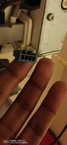

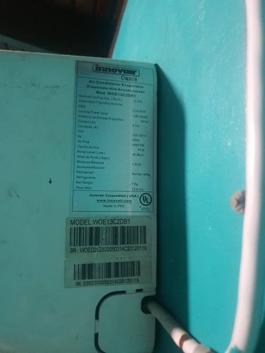

Nerve,I looking for some advice on a fix.A few months ago while putting on the a/c,there was a electricity surge where the current came and went twice all in the space of 2 seconds.Since then,the temperature all over the place.One minute it working good on 19° next minute I sweating and the same goes for any other temperature.You think it might be a sensor or I hadda change the board?It's an Innovair 12000btu unit

any and everyone. Once installed properly, ie vaccume to 500 microns or under, proper lineset length and maintain your unit you should not have an issue. warranty comes from the dealer extended to their 3rd party dealers. Once proper install procedure was done, if you have an issue they send one of their guys to check it and issue the part under warranty or have it fixed under warranty. Once proper install procedure was followed, no issues. If it wasn't, well that's between you and god. nobody ever had to check over my work, the one time men came on one of two warranty issues they was asking me for my tools borrow to get better readings.
supercharged turbo wrote:Nerve,I looking for some advice on a fix.A few months ago while putting on the a/c,there was a electricity surge where the current came and went twice all in the space of 2 seconds.Since then,the temperature all over the place.One minute it working good on 19° next minute I sweating and the same goes for any other temperature.You think it might be a sensor or I hadda change the board?It's an Innovair 12000btu unit
could just be a sensor. Both work in series with varying impedance at temp variances where the board interprets the values.
shoot a pic with the model and I will guide you.
If is board I can tell you who to go by, just tell them is their model ac or they wont sell you cuz men keeping parts for only their products where thing scarce this rounds.

I feeling it could be a sensor too.Every now and again it does work correct but for the most part,the temperature all over the place.

Postby Ted_v2 » December 20th, 2021, 5:05 am
So ghastly369, i find that unit looking really slick in truth.
was the price comparable with other units on the market?
Re: What the Best Split level AC Units...Carrier LG, Panasonic?
Postby gastly369 » December 20th, 2021, 8:06 am
Ted_v2 wrote:So ghastly369, i find that unit looking really slick in truth.
Got on sale for $2499... Friend installed free for me so basically $2499 installed.. Normal price is $3200 for bare unit from courts

Any info on this nerve?

Aye, i forget you yes.
unjack your coil temp sensor and take a dmm to it, should read anywhere around over 4000 ohms to 5500 ohms depending on the temp. Anything outside that, dust bin and get new one. You looking for a 5 kilo ohm sensor, if its shot, shoot me a whatsapp and I will tell you how or where to get one.
You know how to scrap the mofo for diagnosis?
can unpin it and use the old jack or wire stripper, solder and electrical tape of heat shrink.
If its not that, I can walk you through testing the thermostat.
