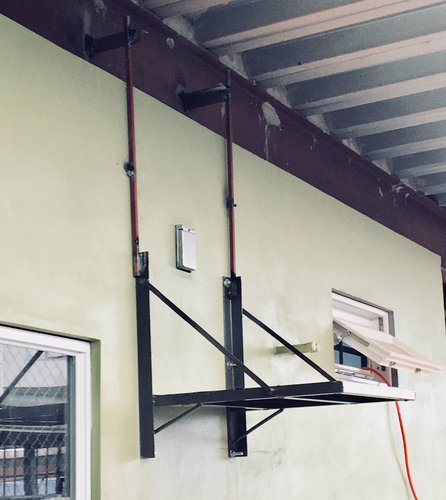

yes the clay brick is my concern, they dont want washers/exposed bolts inside.
just saw that there is an exposed big ibeam running horizontally a few feet above
I am going to weld vertical and diagonal supports to that beam. Should do the trick.
adnj wrote:The bracket looks solid. Your idea to add a floor support would certainly help.
Edit: I believe that the problem is not the shear strength (downward force) of the bracket and fasteners. The problem is the pull-out resistance of the clay block itself. The static load is only 50 pounds max.
If the clay block attachment fails, it will most likely just pop out completely. I would go through the wall.

Was planning on purchasing the simtek line from Home Depot and shipping here...didn’t realise we’ve got similar products available locally...

Postby pugboy » September 8th, 2018, 4:22 pm
Put up water heater bracket today
Added vertical support
rebound
Posts: 1525
Re: Building a house in Trinidad
Postby rebound » September 8th, 2018, 6:11 pm
That is overkill there
