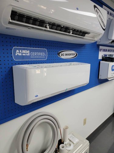

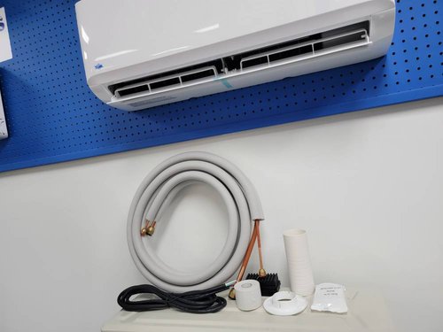

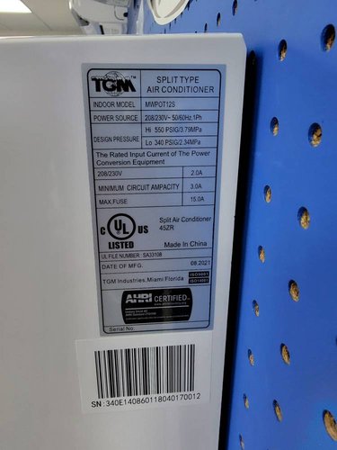

Anyone has TGM or Classic air conditioning? Believe both is same company. See attached pictures. If anyone has experience with it, please share information on it. And how good is it? Inverter types.

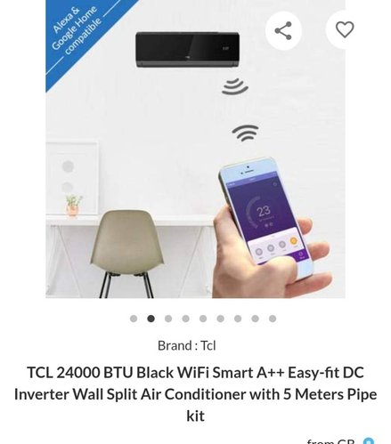

In gonna try out the TCL inverter
Has Toshiba compressor etc
Replacing a 12 year old r22 Panasonic unit

Have a very old TGM...not sure if they give the same service but mine is a very old unit and only thing ever gave was a motor which wasn't painful to replace or labor wise.
Glad to see the name back.
Maraj was a the dealer back then.
Who's selling and what's the price point like? Good components?

Ok that is good to know. Trying to get inverters, ac guys are saying no inverters in stock in Trinidad. I actually sourced the TGM brand from a company in Miami. Not sure about the components, from what I understand, the compressor is from the same company as Panasonic and Toshiba.

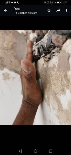

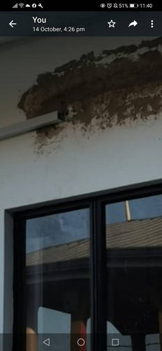

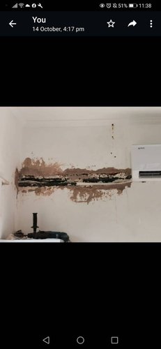

We cut the wall and used the hollow red brick to run the lines. Trunking was not matching the theme so we removed the trunking and did this.
All lines insulated and expanding foam was to be added as extra insulation prior to plastering.
Specific instructions given to not add plenty as it expands a lot. And don't add too much behind. Also trim the excess and then plaster.
Came back and found the lines outside the wall plastered on the wall and water not coming out the condensate line.
Condensate line have a huge belly up.

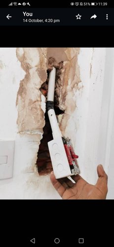

An man who has years of electrical experience and does electrical work for people put lines in the wall and plaster it just so.
I had to tell him put it in conduit.
Seems something wrong with the level, something wrong with the measuring tape and on top of that....

We cut wall, run all lines in cieling in PVC sleeve after insulating them and added expanding foam to the ends to cap them with a grade so any condensation will run outside towards the hole in the wall where the trunking is behind the house.
The request was nothing must show on the sides and front.
A simple condensate line is no biggy.
They plaster raw copper with no insulation just so. Line sweating and mortar falling off. Plumbed the line into the vent for the wastewater system with the roof guttering downpipe right next to it and put trunking which they buy after the request was no trunking.
This is big men we talking about have gyul and thing and engaged and Shiz.
All this is one job I had to do over.
