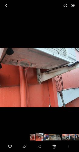

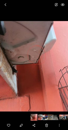

Postby supercharged turbo » July 31st, 2021, 6:40 pm
I've noticed the unit outside leaking water everywhere other than the drain line.I cleaned the drain hole on the inside unit about a year ago becuz it was clogged.Any suggestions as to what causing the leak?
Posts: 23833
Re: What the Best Split level AC Units...Carrier LG, Panasonic?
Postby nervewrecker » August 4th, 2021, 10:55 pm
supercharged turbo wrote:I've noticed the unit outside leaking water everywhere other than the drain line.I cleaned the drain hole on the inside unit about a year ago becuz it was clogged.Any suggestions as to what causing the leak?Screenshot_20210731-184008_Gallery.jpgScreenshot_20210731-183952_Gallery.jpg
condensation on the suction lines and accumulator and/or receiver back to the comp. you can insulate it but it usually exposed to heat to make sure all liquid boil off and not come back to the comp. A comp cant compress liquid, only gas. The change in cross sectional area / diameter / bore facilitates a pressure change / decrease further facilitating the phase change.
