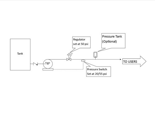

Will this work. Share your views....
I am thinking about doing this for the following reasons.
1. If it works it should be more reliability than a smart-head.
2. It will allow the pump to keep running once any tap is opened. (Save energy- less inrush)
Posts: 29377
Re: Which residential water pump to buy?
Postby pugboy » July 24th, 2017, 7:27 am
that is essentially a cycle stop valve
but the technicality is that if two taps open at the same time they will only get approx 25psi each
as the regulator doesn't have capability to have higher volume
at least that is the technicality from what I have ready
