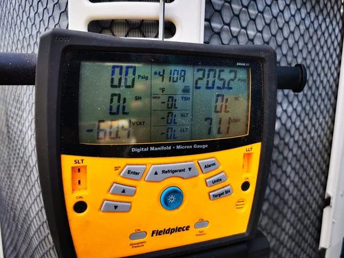

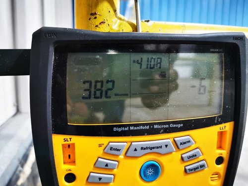

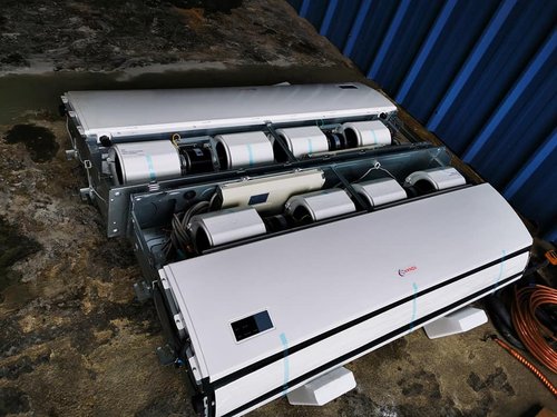

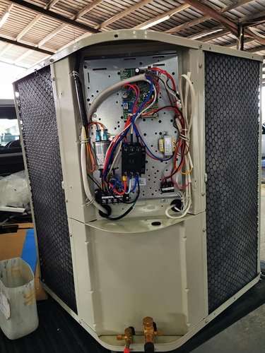

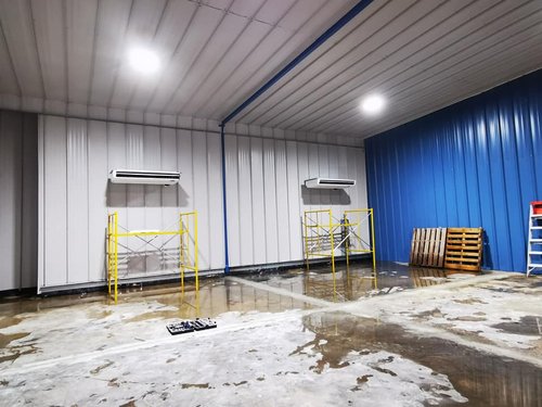

pjfred wrote:Is yonan a reliable brand of ac?
They are the same as the rest of midea built units. IIRC they initially came with TGM compressors vs the rest that has GMCC. TGM is a decent manufacturer, I have a few yonan units in service some time now with no issues. The 24 is a full size 24 unlike some other brands that claim 24 but are 21.
They are very quiet and have decent control systems. Haven't checked if the signal wire is in fact a comm by trying to swap out or mix and match but a board not hard to find.
I have put in 5 tonne, 3 tonne and 24's with no issues. The noise level on par with GMCC rotary. Gree built scroll comps are by far the quietest I have in service. On a 5 tonne the noise the air make coming through the condenser fan is louder than the compressor. You can carry on a conversation in front the 24 condenser without having to raise your voice.
Servair will have a shipment here soon while Cecair and Ramkal hardware usually have em.
Full nitrogen pressure testing before vaccume to under 500 microns before opening valves. Inline drier installed as per proper practice and these units are in service 24/7.
