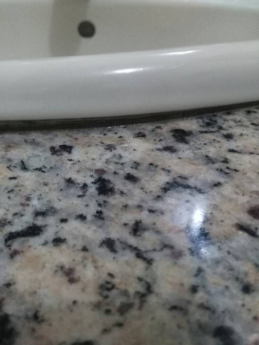

Hey guys , need some more advice. What type of sealant to use if i installing a top mount sink on a granite surface.
Re: Building a house in Trinidad
Postby rspann » June 18th, 2018, 9:41 pm
eitech wrote:Hey guys , need some more advice. What type of sealant to use if i installing a top mount sink on a granite surface.
I going to tell you something that might sound funny. Use urethane, the one they use to install Windscreen. It won't ever let go, and doesn't get mildew like silicone. Run a bead ,rest the sink on it. Next day tape around the sink and then the granite . Leave a 1/4 inch gap between them and run a thin bead ,smoothen it with a finger or a wet cloth. It looks like a gasket and will never fail. I did sinks fifteen years and they still look perfect.

Urethane sealer.
eitech
Posts: 3629
Postby eitech » June 18th, 2018, 11:16 pm
rspann wrote:
Urethane sealer.
It comes in caulk application as well?
Postby rspann » June 19th, 2018, 7:22 am
It's a cartridge that uses a gun to apply. When it's opened it gets hard, so when you use it make sure to leave an inch outside to seal the cartridge.
